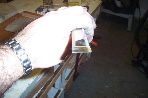

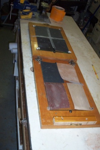

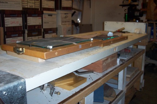

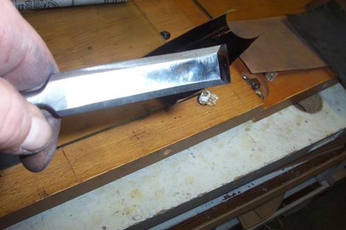

Hi folks, after watching a video that was posted by my good pal Rod True, i decided to give that a try and the results were quite amazing for my very first try at sharpening chisels, better late than never they say huh?

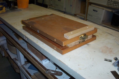

I purchased 2 glass plates from Lee Valley and inserted them in a foldable jig of sort then i proceeded with different grits, dry on the first lower grits and with water on the higher ones, polished them to a mirror sheen at the end, i still need a bit of practice but with good elbow grease and good will, i think i'll have them all sharpened very soon, thanks Rod!
Her's the jig
Here's the result!

That looks like a great set up to hold the glass.
Great idea!
PostPosted: Sun Jan 07, 2007 4:54 pm
Thanks Jim, i used mirror hooks?clamps? plastic thingies anyways, they help keep the sandpaper down in the corners and the plates down on the surface.

J and others, just so you know it's a video file from an article in woodsmith magazine.
Now Serge, that looks great. Did you do them by hand or with a honing guide?
If you don't have a honing guide, I would suggest getting one. Even a cheap one is better than going at it by hand. Makes for a more even bevel and for a nice square edge. If you have one already, just ignore me
I must say thought that that chisle sure looks good Bro. Rod True39090.0581944444

Rod, i do have a sharpening guide but how could i ever ignore the guy that delivered me from my ignorance?
I have the same exact honing guide as the guy in the video but mine seems to be wobbly a bit, i am seriously considering buying another one from Lee Valley that would certainly be more sturdy and accurate although pricey!

Hey Serge, thats a lovely hairy arm in photo No 4.
Just perfect for testing chisels on! kiwigeo39090.2644212963
